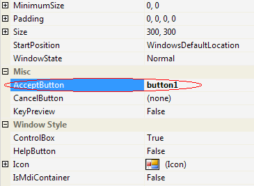

I have a login form and after filling the fields, I'd like the user to be able to press Enter and it should act the same way as if the user pressed the submit button.
Re: Combobox and a wish....
Post by Neo » Thu Feb 04, 2010 8:09 pm
On the form properties (not button properties), find AcceptButton and set it to button you want to act as the default as in screenshot.
