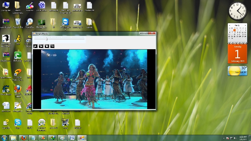

Hi
In .net most of the time you use SoundPlayer class to play media content. But what if you want to play a mp3 file or video file?? This code shows how to play any media format using C#. I’m using a library called “Quatrz.dll”. This is a very powerful library which is powered by Direct Show. You can find this library in C:\Windows\System32 directory. All you have to do is open up the VS and create a new project. In the solution explorer, right click on the Reference-> Add Reference -> Go to “Browse” tab and give the Quatrz.dll path. (in C:\Windows\System32\ Quatrz.dll ).
I have commented the code. Guys please note that I couldn’t test this thoroughly. So this may have bugs.
Hope this will help you :mrgreen:
soundtest.zip
(785.82 KiB) Downloaded 679 times
