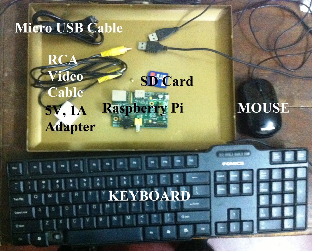

You need the following items to get started with Raspberry Pi :
- Class 4 SD Card (minimum 4GB)
- SD Card Reader to write OS files to the SD Card (You may use your laptop’s memory card reader).
- Micro USB Power supply capable of supplying at least 700mA at 5V. You can use your old Android Phone’s adapter.
- HDMI Monitor or DVI Monitor or TV
- HDMI Cable or HDMI to DVI Converter or RCA Cable.
- USB Keyboard
- USB Mouse
If you have these items with Raspberry Pi, you can get started with it.

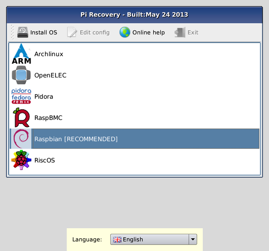

When the Raspberry Pi boots up for the first time, it will automatically loads the Recovery Mode to choose an OS to install.
Choose the required OS to install it. Rasbian is the recommended OS by Raspberry Pi Foundation. After the installation the Pi will reboot and loads the installed OS. If you want to change the OS, you can initiate the Recovery Mode by holding shift key during boot up.

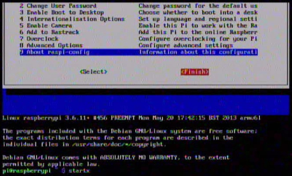

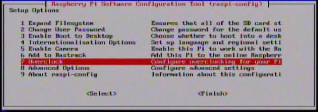

When the Raspberry Pi boots up for the first time after the OS installation, you will see a Software Configuration tool named raspi-config.
Don’t bother about these configurations now. We can access and change Raspberry Pi configurations any time by using the command raspi-config on the command prompt. In the next tutorial we will explain these settings in detail. Now skip this by selecting Finish using Tab key.

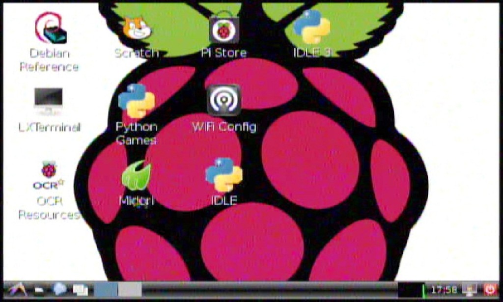

Then it will load the command prompt. You can start the GUI Environment by using the startx command.

Now you can start Python programming by using Python IDE by simply opening the IDLE 3. Stay tuned with us to lean more about programming.
