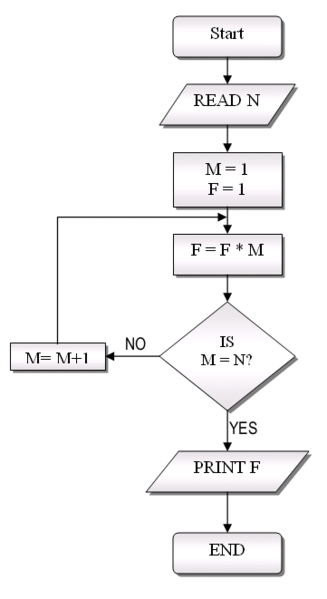

When I was surfing the net, I just thought to search about Flow charts.
Then I found the wiki page about it.
http://en.wikipedia.org/wiki/Flowchart#Examples
In there I saw this simple flow chart.
And I made a program for that in Java. But it doesn't work as expected.
If I enter "1" I get correct result.
But if I enter another amount, Then nothing happens it only prints "1' no matter what amount I enter :? I tried to correct but I couldn't. I even searched on Google to find out a similar program but they are different than my code.

When you input 1, it will print the value of f since m==n. But nothing is happening other than m++ when it comes to the "else" part. And at the end of the program you are printing the value of "f" which is not affected by any code segment other than first f=f*m after initializing the variable.
This is a sample that accords the flow chart
