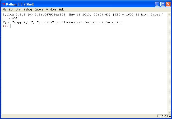

- Open the Python(GUI) IDLE after installation
After Opening Python Shell

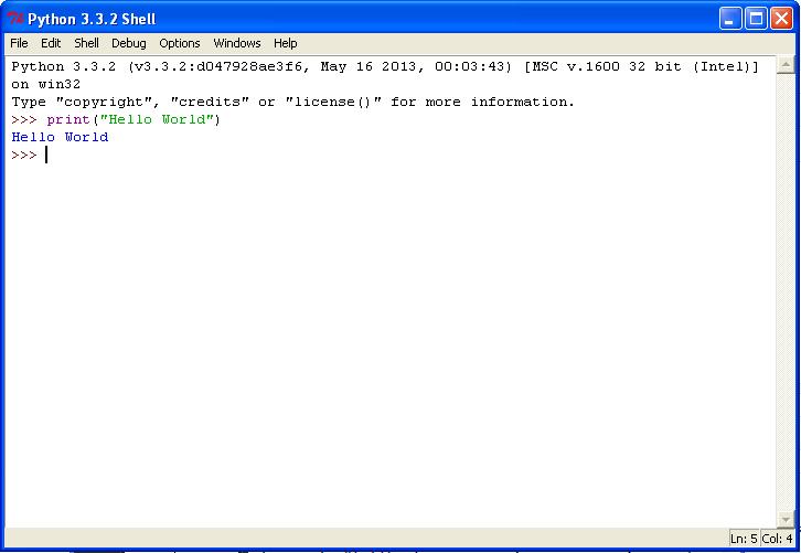

Any tutorial for a programming would should start with a “Hello World”. So lets start with the same. In the GUI type the following print statement.
print("Hello World")
Then press Enter. You can see the output directly in the interpreter as shown below.
Output at the Shell Interpreter – Python

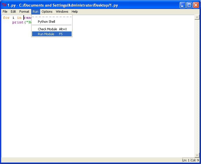

-> Click File >> New
-> It will open a text editor and type the following program there.
for i in range(0,10):
-> Save It

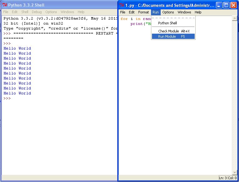

-> Run >> Run Module
Creating and Running a Python Program
In this example “Hello World” is printed 10 times using a for loop. The value of i will be incremented from 0 to 9. The output will be displayed at the Shell as shown below.
Output of Python Program
