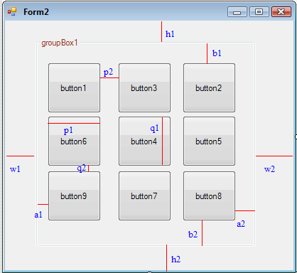

To be sure, lets discuss base don an image.
Now we can write simple formulas for Group box width and height as below. Note that draw position of the left-top button is (a1, b1).
N - number_of_buttons_per_side
gbox_width = a1 + a2 + (p1 * N) + p2 * (N-1)
gbox_height = b1 + b2 + (q1 * N) + q2 * (N-1)
Similarly, we can write formulas for form,
form_width = w1 + w2 + gbox_width
form_height = h1 + h2 + gbox_height
Note: p1, p2, q1, q2, (a1 + a2), (b1 + b2), (w1 + w2) and (h1 + h2) are all constants.
These values will change for given N from your combo box.
Can you implement this, so the logic will become clear?
