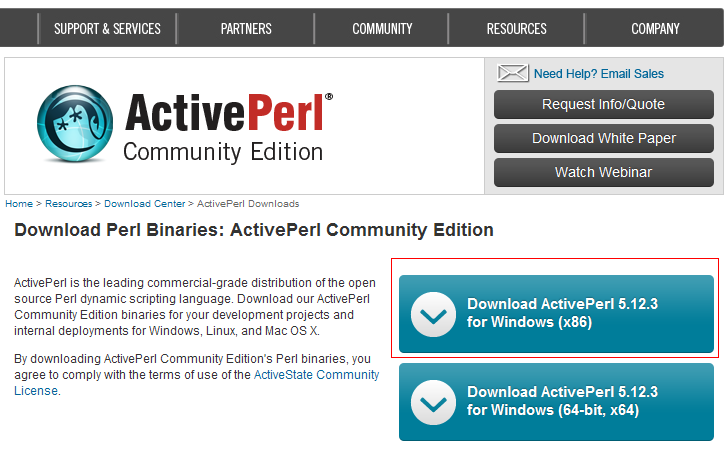

  1. Go to http://www.activestate.com/activeperl/downloads and download the version you want. In my case, I download the x86 version which is 5.12.3 at the time of making this tutorial. The Installation file is 24.6 MB.
    I was downloading with Opera which took about 2 minutes to download the file.
    The download files was named as ActivePerl-5.12.3.1204-MSWin32-x86-294330.msi

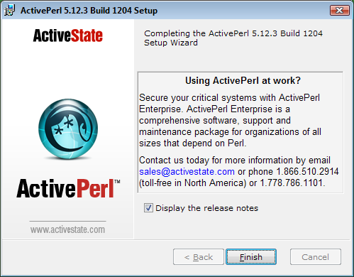

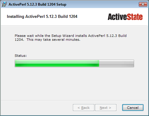

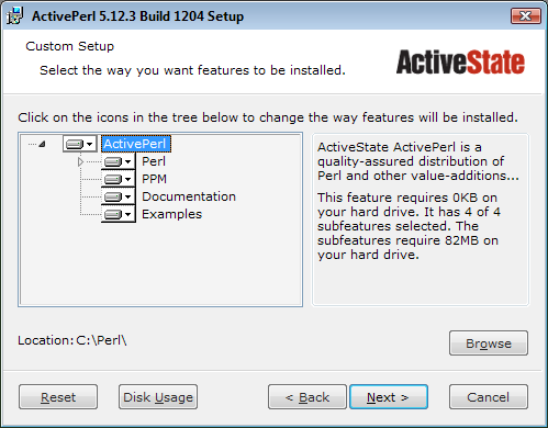

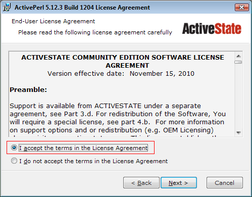

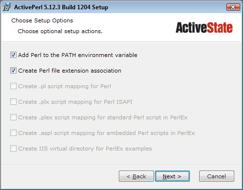

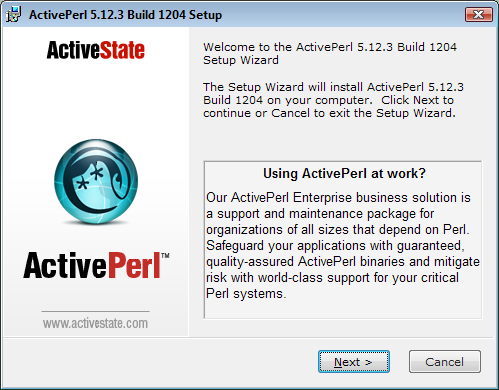

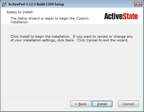

  2. Double click on the file and continue through the installation process as below. (I didn't want to do any change rather than keep pressing on Next)

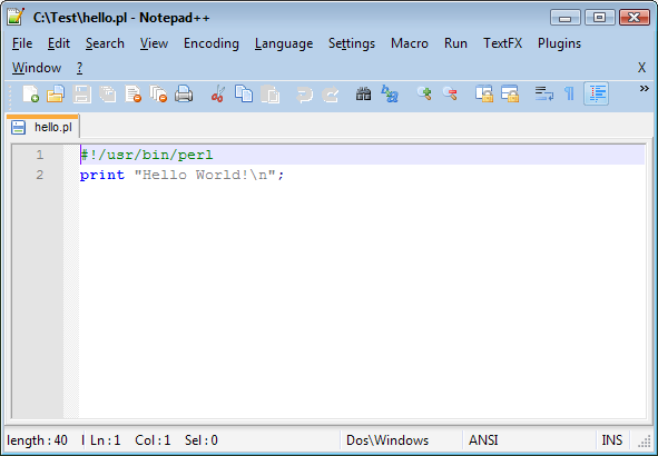

  3. After finishing the installation, we can try to run a Perl script file to display Hello World. Open a text editor (Notepad is fine), type following code and save the file as hello.pl.
    #!/usr/bin/perl
    print "Hello World!\n";
    I use NotePad++ (free) which support syntax highlighting for Perl.

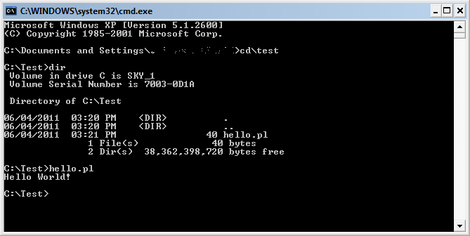

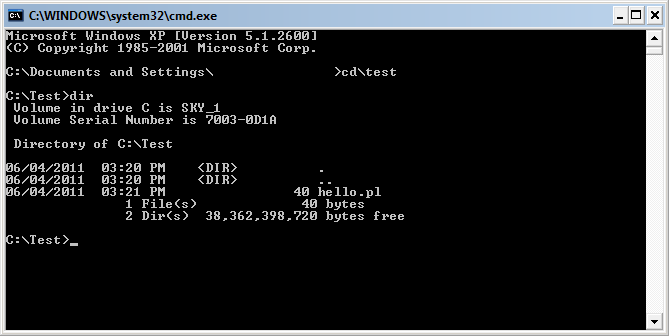

  4. Now open command prompt (Start Menu -> Run -> Type "cmd" and Enter) and change directory to the folder with your file. You can list down file using dir command to see whether the file exists.
  5. Now type hello.pl to run the Perl script file you have just created.
