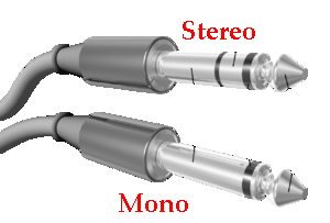

Hi friend,
u have wrong with stereo and mono.
mono means single audio line. but both of ur radio and pc have stereo jacks.
i think ur sound card has 4audio oupputs or u think both of line in and out are outs.
try with ur last pic's cable by connecting to one by one sound card's ports.

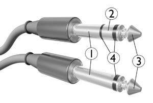

TRS Jack
  1. Sleeve: usually ground
  2. Ring: Right-hand channel for stereo signals, negative phase for balanced mono signals, power supply for power-requiring mono signal sources
  3. Tip: Left-hand channel for stereo signals, positive phase for balanced mono signals, signal line for unbalanced mono signals
  4. Insulating rings

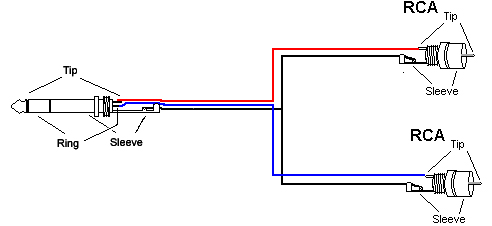

RCA Jack
Cable Connection
Make sure you use shielded copper cable to reduce attenuation.

Post by Rksk » Mon Aug 23, 2010 5:08 pm
hi G-sparkZ,
This is the final answer for ur problem.
Normally in elecronic filed we name jacks as below.
U have only to connect ur cable to ur soundcard.
And this picture has 2 stereo jacks. I think it is a cable of a headphone witch came with a mic.
Think this will helpfull. :D
