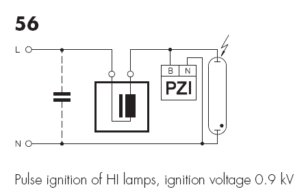

man sodiam lamp ekakata ignitor 1k gaththa kotuwen . eka pin 2 ignitor ekak . eth a lamp ekata kalin set karala thiyenne pin 3 ignitor 1k , a electrition pin 2 ignitor eka ara lamp ekata match wenavada kiyala danne na .
me thiyenne ignitor eke gahala thiyena akuru tika
VS power ignitor vossloh schwabe
CD-Z-400M
220-240V/50-60Hz
for lamps
HS70-400W
HI70-400W
IB max - 5A
made in germany
Pin 2 nam karala thiyenne B N kiyala.
500/=
meke thiyena podi diagram eke hatiyata chok eken passe sodiam lamp ekata parallel danna kiyala thiyenne idnitor eka
pin 2 saha pin 3 wenasa mokadda ?
me lamp eka 400W lamp ekak . ekata me pin 2 ignitor eka match wenavada?

Post by Neo » Tue Nov 09, 2010 1:58 pm
Similar to a fluorescent light, the ignitor provides a high voltage potential to excite the sodium gas within the bulb.
Product link of your item is at http://katalog.vossloh-schwabe.com/cgi- ... fnbr=14570
It has two pins as you said. When the pins are named as B and N, the circuit diagram should be as follows.
See the full set of circuit diagrams in following PDF.
http://www.vossloh-schwabe.com/images/o ... 008_GB.pdf
Read more on VS ignitors at http://www.vossloh-schwabe.com/eng/tech ... en/157.php
Good luck and don't forget to submit your feedback!
