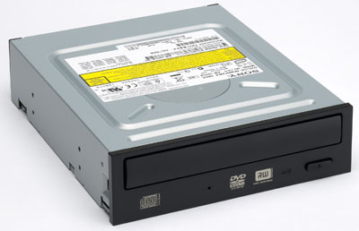

    sonydvd writer.jpg (17.18 KiB) Viewed 5273 times
    By far the quickest and least expensive way to duplicate a disc is to copy it using a computer outfitted with a CD/DVD/BD recorder combined with off the shelf writing software. In addition to creating discs from scratch, many basic writing software packages will duplicate most standard CD/DVD/BD formats. Specialized copying software is also available with more sophisticated capabilities such as the ability to simultaneous duplicate to multiple recorders. But remember that the ability of a system to copy specific disc formats depends upon the individual capabilities of the software, reader and recorder used. It is therefore advisable to check with the respective manufacturers for specific information.
    Typically, discs are duplicated DVD to DVD/CD to CD/BD to BD by using the computer’s CD/DVD/BD-ROM drive as the master source feeding the copying recorder. In cases where a separate reading drive is not available the master is first downloaded to the computer hard drive using the reading ability of the recorder and later written back to a blank disc using the same recorder. Employing the computer’s hard disk as an intermediate copying step is also a common tactic used when dealing with poor quality source discs or other situations where computer systems are not fast enough to keep up to the speed set on the recorder.
