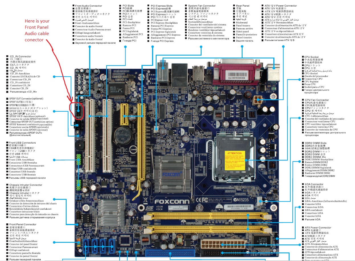

I added a picture there you can see where to connect it.
There are detailed info in the Motherboard Manual
Here is the link to download it
http://www.foxconnsupport.com/download. ... d%20Manual
I didn't upload it here because it's 9MB.

Nipuna wrote:I added a picture there you can see where to connect it.
Friend,

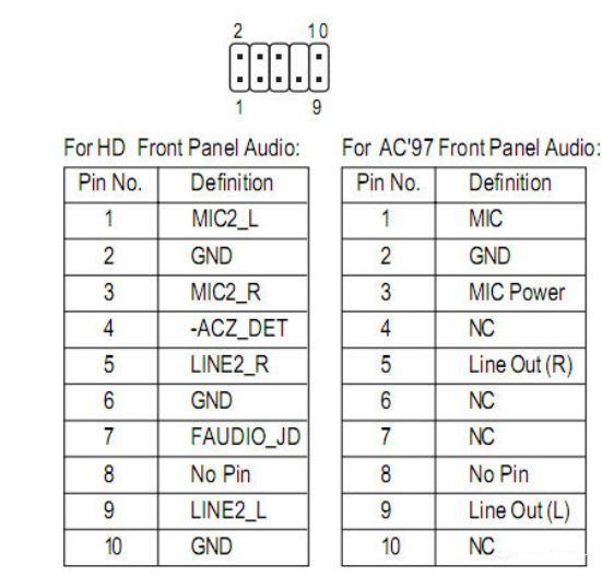

i know location of front audio connector.but,i dont know pin oder of connector.wirs of cable have a name for eatch.as SpkR,SpkL,Gnd,....ect.i can understand this short name.
i want to know pin of connector for eatch wire witch start in front panel of casing.
Thank...

Dear Nipuna,
your picture of mother board is Foxconn 45CM-S.not 45GM.
45GM has a flopy connector beside front audio connector.
Thank u Nipuna.if u can,give me pin oder.i think,45GM audio connector is same to 45CM-S audio connector.perhaps all audio connector.

This is the standard pin order of front audio connector.

Thank u Saman.you could undestand my problem.your image is compleat answare for my problem.
and,
Is this diagram the standerd for any mother board?
Thanx
Yes it is. There are two standards and both are explained in the diagram (HD and AC97).
