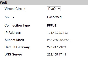

check my setting on a SLT ADSL connection with a class C WAN IP.

Got it. 255.255.255.255 is for PTP networks. Thanku :)
