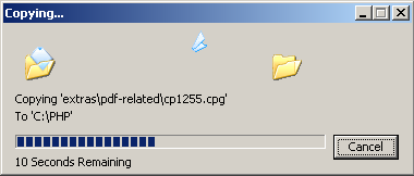

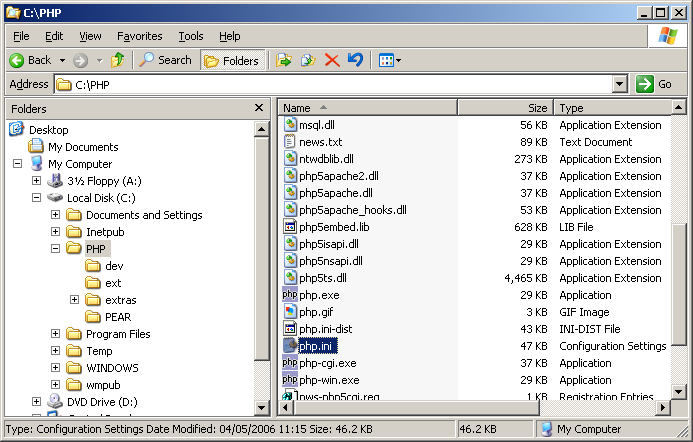

Start by creating a directory into which you will extract the downloaded PHP files (php-5.1.4-Win32.zip). In this example I’m going to use C:\PHP as my installation directory. Then extract the files from php-5.1.4-Win32.zip into C:\PHP
If you need to use the additional PECL modules then extract the files from ‘pecl-5.1.4-Win32.zip’ into the C:\PHP\ext directory.
Next locate the file ‘php.ini-recommended’ in C:\PHP and rename it to ‘php.ini’ (without the quotes of course)

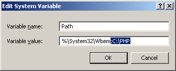

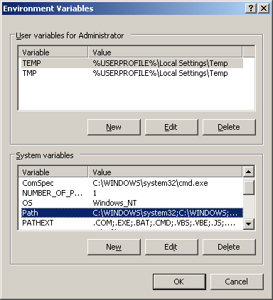

You also need to add the location of your PHP directory to the server’s PATH environment variable so that Windows knows where to look for any PHP related executables (such as the PHP extension DLL‘s). To do this Right-click on My Computer, click Properties and on the Advanced tab click Environment Variables. In the Environment Variables dialog box, under System variables highlight the Path variable and click Edit.
Add ‘;C:\PHP’ (be sure to include the semi-colon separator) as shown here and click OK. You need to re-boot the server for this change to take effect.

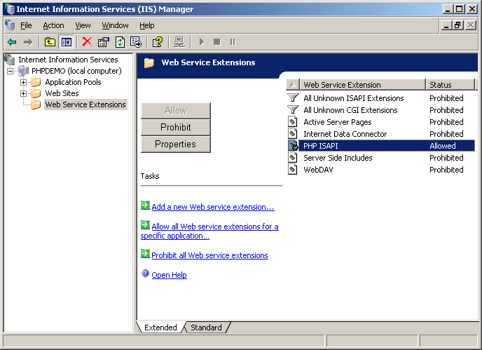

First we need to create and then enable an appropriate Web Service Extension so that IIS will both recognise and allow PHP files to be processed by the appropriate script engine.

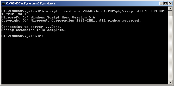

You can use the Internet Information Services (IIS) Manager GUI method to perform this task (and most tutorials and guides you may find tend to use this method) but there is a much quicker way of doing this; namely using the ‘iisext.vbs’ Command-Line Administration Script, which you will find in C:\Windows\system32 by default.
Assuming you are using the same directory structure as I am in this walkthrough you can simply copy and paste the following line of text and execute it at a command prompt from C:\Windows\system32 :
cscript iisext.vbs /AddFile c:\PHP\php5isapi.dll 1 PHPISAPI 1 “PHP ISAPI”
As you can see, this script creates a new Web Service Extension named “PHP ISAPI” with a status of Allowed.

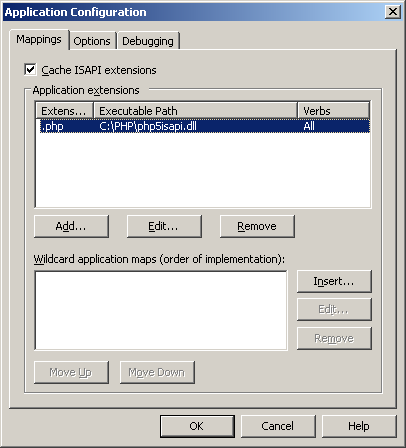

You can use the default web site for test purposes if you prefer but in this example I am going to use a dedicated PHP test web site. I have created a test web site which has a home directory of C:\test. The next step is to create an Application Extension Mapping at the web site level for PHP scripts. You can perform this step using the MMC GUI but I am going to use AdsUtil.vbs for this demonstration.
There is actually a good reason for doing this - as I intend to use this web site purely for PHP testing I can remove any unused application mappings on my PHP web site, such as .idc, .shtml and .asp, etc.

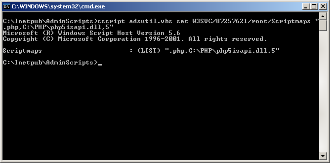

I can achieve this simply by executing the following script from a command prompt at C:\Inetpub\AdminScripts :
cscript adsutil.vbs set W3SVC/87257621/root/Scriptmaps “.php,C:\PHP\php5isapi.dll,5?
Running the above command has the effect of setting the Scriptmaps metabase property for Web Site ID 87257621 so that only the .php Application Extension Mapping is enabled.
However, as you can see, this script doesn’t just add the PHP script mapping to the web site - it removes any existing mappings as well - so only use the above command if you are sure that you want to remove any existing application mappings on your chosen web site. In other words, if you run the above script against a web site which hosts any other applications (such as ASP) then it will break that site’s functionality and you will need to repair the application mappings manually. So only do this if you are sure that you only want to run PHP on your chosen web site.

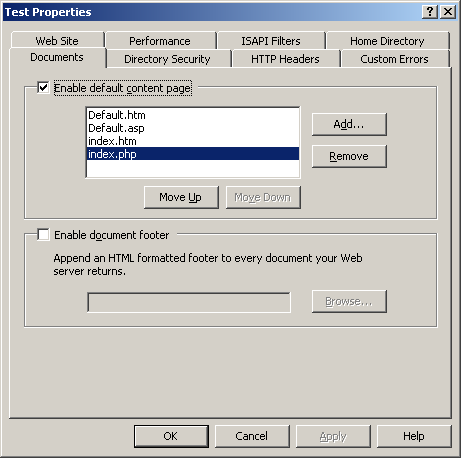

Save the file as index.php in the root of the test web site. Next create a new default document type of index.php on the test web site (this step is optional but it just makes browsing a bit easier)

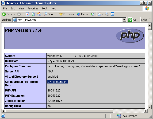

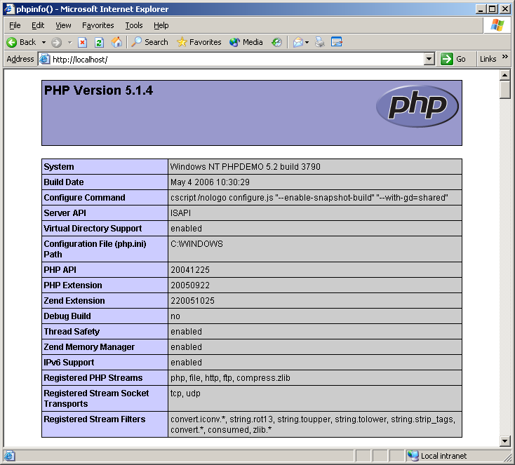

Browse to http://localhost (or http://localhost/index.php) and you should see the standard PHP configuration details page.
However, if you look carefully at the above page you will notice it is indicating that my ‘php.ini’ file is actually located in ‘C:\WINDOWS’ even though there is no such file in my C:\WINDOWS directory. This is because the ‘php5isapi.dll’ file is actually compiled with this location as its default value. A number of existing PHP and IIS tutorials suggest that you should copy the ‘php.ini’ file to the C:\WINDOWS directory - but what if you don’t want to do that ?
Well, you don’t have to because PHP allows you to actually configure a custom value for the ‘php.ini’ file location. There are a number of ways to do this but perhaps the simplest is to configure the PHPRC environment variable. Further details of how this works can be found here : http://uk.php.net/configuration

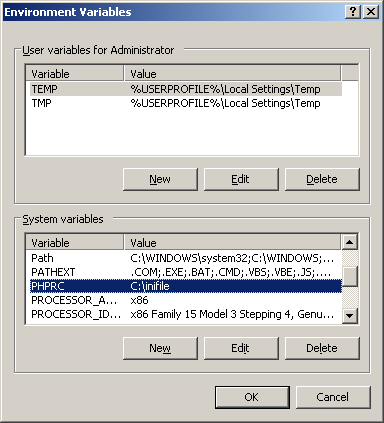

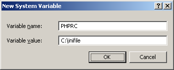

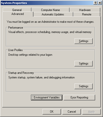

In order to do this I need to create a new System environment variable named ‘PHPRC’ and provide the appropriate values. Right-click on My Computer, click Properties and on the Advanced tab click Environment Variables.
In the Environment Variables dialog box, under System variables click New. In the New System Variable dialog box type PHPRC for the variable name and then enter the desired path to your ‘php.ini’ file’s location.
Then click OK and you will see that a new System environment variable has been created. In order for this to take effect you need to re-boot the server at this stage.

Now if we browse http://localhost we can see that PHP is indeed looking for its ‘php.ini’ file in the ‘C:\inifile’ location which we specified previously.
And that’s it. You should now have a working installation of PHP running on IIS 6.0.
