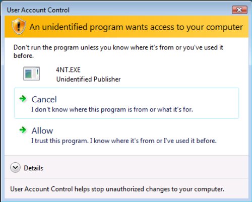

  2. Tame UAC
    Windows Vista's User Account Control raises so many alerts that many people just turn it off. But do that and you'll also lose useful features like IE's protected mode. If you really can't live with UAC, try disabling the alerts for administrators: you won't get any more hassle, but UAC will run in the background and you'll still get its other features. To do this, set ‘HKLM\Software\Microsoft\Windows\CurrentVersion\Policies\System\ConsentPromptBehaviorAdmin’ to 0. You can restore normal UAC behaviour by setting it to 2.

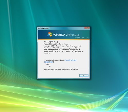

  3. Change the owner
    Install Windows on your PC and you'll be asked to enter your name, which is then stored as the registered owner (run WinVer to see this on your system). If you’ve got a second-hand PC, you probably want to change the name stored as the registered owner. There's no obvious way to do this, and that's where the Registry comes in. Browse to ‘HKLM\SOFTWARE\Microsoft\WindowsNT\Current Version’ and you'll see both a ‘RegisteredOwner’ and ‘Registered Organization’ value. Double-click either to change them.

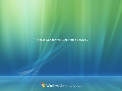

  5. Troubleshoot startup
    If Windows is taking its time to start up or shut down, there might be a problem. To find out what’s going on, go to ‘HKLM\SOFTWARE\Microsoft\Windows\CurrentVersion\Policies\System’, create a DWORD value called ‘verbosestatus’ and set it to 1. Restart your PC and Windows will tell you what it’s getting up to.
