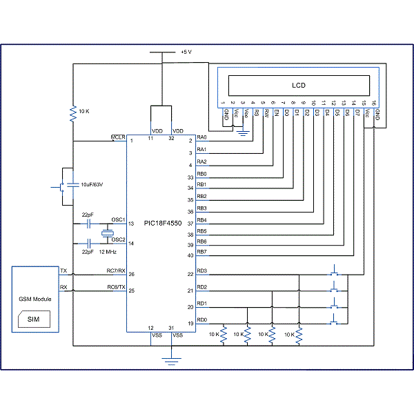

Sample circuit diagram on connecting a GPRS module such as the ones you can find from TRONIC.LK.

	temp=0;
	tx_data(enter); // Send ASCII code for 'Enter' key
	while(temp!=1);
void output(void) // To print data on LCD
	lcdcmd(0x01);
	i=-1;flag=0;
	while(i<j)
		if(flag>1)
			flag=0;
			Delay_ms(500);
			lcdcmd(0x01);
			lcdcmd(0x80);
		if(data[i]==0x0A) // This condition is to avoid double Enter
		// during execution of a command
			flag++;
			lcdcmd(0xc0);
		if(data[i]=='>'||data[i]=='"') // Not to print this character
			i++;
			lcdcmd(0xc0);
		if(data[i]!=0x0D&&data[i]!=0x0A&&data[i]!=0x1A) // Condition to print the data
		// except 'Enter','New line' and 'Submit'
			lcddata(data[i]);
			i++;
		else
			i++;
		Delay_ms(300);
	lcdcmd(0x01);
void tx_data(unsigned char serial_data) // Transmit data function
	TXREG = serial_data;
	while(PIR1.TXIF==0);
void interrupt()
	data[j]=RCREG; // Store the data into array when Reception interrupt occurs
	value=RCREG;
	j++;
	temp=1;
void lcd_ini()
	lcdcmd(0x38); // Configure the LCD in 8-bit mode, 2 line and 5x7 font
	lcdcmd(0x0C); // Display On and Cursor Off
	lcdcmd(0x01); // Clear display screen
	lcdcmd(0x06); // Increment cursor
	lcdcmd(0x80); // Set cursor position to 1st line, 1st column
void lcdcmd(unsigned char cmdout)
	lcdport=cmdout; //Send command to lcdport=PORTB
	rs=0;
	rw=0;
	en=1;
	Delay_ms(10);
	en=0;
void lcddata(unsigned char dataout)
	lcdport=dataout; //Send data to lcdport=PORTB
	rs=1;
	rw=0;
	en=1;
	Delay_ms(10);
	en=0;
