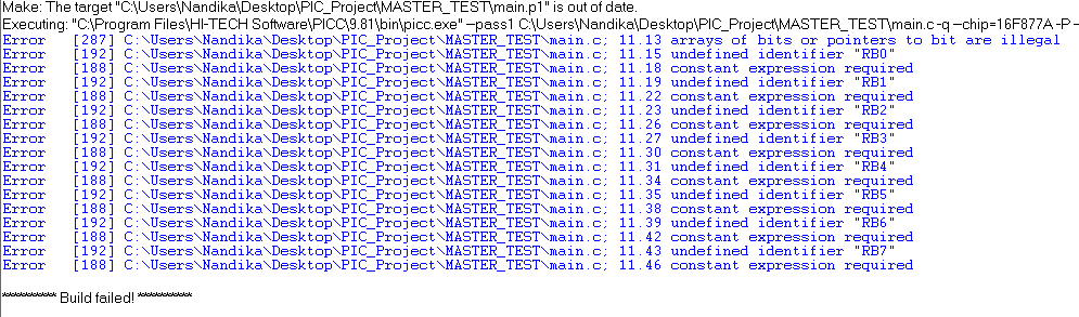

compiler gives following errors...
bit data type not allowed for array implementation. :(
How can I implement an array with PORTB pins?

As per the error says, RB0.... RB8 are not defined. Make sure that you have includes pic.h

as said , you could not create arrays of bits.
And your defines are wrong.
