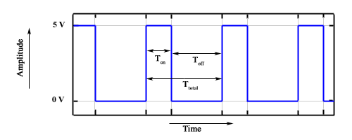

Pulse-width Modulation is achieved with the help of a square wave whose duty cycle is changed to get a varying voltage output as a result of average value of waveform. A mathematical explanation of this is given below.
Consider a square wave shown in the figure above.
Ton is the time for which the output is high and Toff is time for which output is low. Let Ttotal be time period of the wave such that,
Duty cycle of a square wave is defined as
The output voltage varies with duty cycle as...
So you can see from the final equation the output voltage can be directly varied by varying the Ton value.
If Ton is 0, Vout is also 0.
if Ton is Ttotal then Vout is Vin or say maximum.

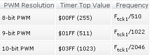

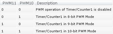

Most of AVR controllers have onchip PWM channel which makes PWM usage much simple and more accurate. AVR timers or counters can be used in PWM mode without disturbing the basic timer function. As in case of AT90S8515, Timer1 can be configured in PWM mode by setting PWM11 and PWM10 bits in TCCR1A register. Following modes are available for PWM:
The pre-scalar source for Timer/Counter1 can be selected with the help of clock select bits in TCCR1B register (more information please check datasheet at page 37).

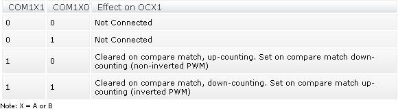

Width of pulse is loaded in the timer output compare registers OCR1A (OCR1AH & OCR1AL) and OCR1B (OCR1BH & OCR1BL). Timer/Counter1 acts as an up/down counter, counting up from $0000 to TOP (see table below), where it turns and counts down again to zero before cycle is repeated. When the counter value matches the content of 10 least significant bits of OCR1A or OCR1B, the PD5 (OC1A)/OC1B pins are set or cleared according to the settings of COM1A1/COM1A0 or COM1B1/COM1B0 bits in Timer/Counter1 Control register (TCCR1A), see table below.
