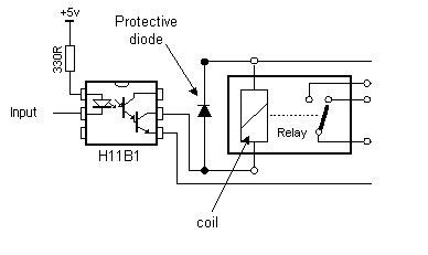

This is a very common problem. I would recommend you to isolate the microcontroller circuit from relays using optocouplers (Aloso known as Opto-isolators). This is the best solution.

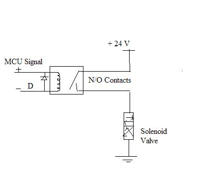

Hi Friend ,
Here is the circuit for connecting the Relay. Make sure to connect a Diade ( Rectifier Diode like IN 4001) inbetween
the coil of the Relay. (Between two control signal terminals) Diode should be connected reverse bias. This Diode is very much help full to avoid restarting the microcontroller , when the relay is operating.
And it is better to connect the microcontroller signal to Relay through a opto couple. This will minimise the effectes of external circuit , to the microcontroller control circuit
Good Luck
Good Luck

As neo correctly stated, this is a very common problem which has many solutions depending on your design requirements. A very good design practice for any microcontroller is to have output isolation (whether built-in isolation is provided or not). This essentially means NOT connecting output pins DIRECTLY to external circuits.
Common practice is to use opto-isolators (opto-couplers). These silicon devices has an LED and Opto-Transistor coupled inside a plastic packaging, which isolates two sides electrically. No electrons passed from one side to the other. But Signal is picked up and carried from one circuit to the other means of light. When buying opto-isolator, always check the specification to see if that can handle the load side of the circuit (in your case the relay coil voltage and the current).

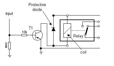

Another approach is to use a transistor or better a FET. This acts as a buffer/amplifier which provides necessary isolation and power to drive the load.
Since you are using a Relay, which is an inductive load, back EMF has to be suppressed using a blocking diode.

- Transistor isolated output driving a relay

- Opto-isolated output driving a relay
