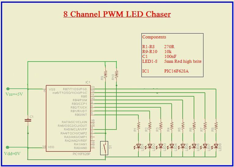

This neat little circuit provides 8 LEDs directly driven from the PIC along with a single mode control switch. The firmware elsewhere on this page drives the LEDs with a 5 bit PWM signal providing each of the 8 LED channels with four levels of intensity; off, dim, mid, bright. A number of sequences are programmed into the firmware to provide some interesting visual effects and chase sequences, including the classic effect seen on the car in the Knight Rider TV series.
The software has sequential, random and manual sequence run modes and manual advance to the next sequence in any mode. The selected sequence and mode are also saved to non-volatile memory so it will always restart in the selected mode.
You can use it with different sized LEDs and mixed colours, as well as fewer than 8 LEDs. As well as using it as a LED chaser it is great for adding effects to toys and models.

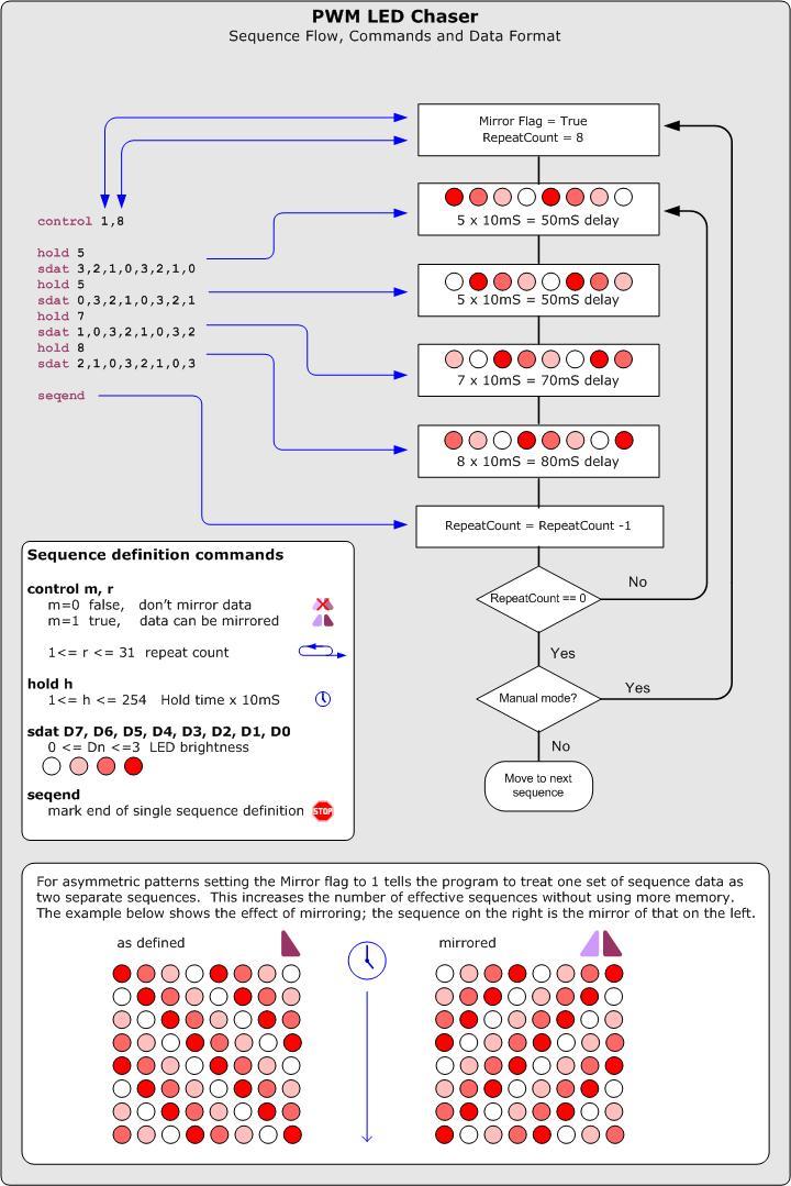

Description of Sequence Data
The data used to create the sequences is held in a separate include file. You can add, remove or edit this data to create your own chaser sequences.
To make the creation of the data file easier a set of macros have been defined which are used to create the sequence data. This is described in the below image.
If you download the source code and look at the file named pwmc_SeqData.inc you can see the data used in the project. You might want to edit this file as a starting point to create some sequences of your own.
Notes:
1.In manual mode, when the repeat count reaches zero it will restart the same sequence, to advance to the next sequence press the switch.
2.In Random mode it will the select a random sequence number to run. If the Mirror flag is true for that sequence it will also randomly choose to mirror the data or not.
3.In auto-sequential mode if the Mirror flag is true it will run the sequence and then repeat it with the data mirrored.
