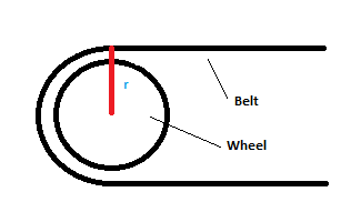

what would be the correct way of calculating the number of steps required to move lead screw to a 1mm or 1inch,
L = ? × r (when ? is in radians)
L = (? × ?/180) × r (when ? is in degrees)
? - step angle
r - radius of the wheel connected to stepper motor
L - distance travelled
or
L = X × Y
X - lead screw revolutions per inch/mm
Y - motor steps per revolution
Re: Connecting Stepper Motors to Microcontrollers Tutorial
Post by Neo » Mon Mar 04, 2013 7:48 am
r? is the length moved along the belt where r is the radius of the wheel connected to the stepper motor to drive the belt + height of the belt.
Remember, the actual movement on the belt could be slightly different due to mechanical errors such as uneven belt movements along the pulleys, belt play, etc... So to compensate with that, you must do calibration to the unit. Here is a simple procedure to do so.
