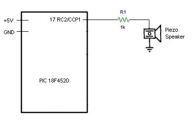

Hey Deepak,
This is nothing more than beeping. If you need more quality, you better use PWM to control the frequency. Have a look at the following circuit diagram.
Instead of a piezo speaker, you can use a 8 Ohm speaker here. However with a simple arrangement as below, you can drive a piezo with PWM well.
Here is a sample PWM code
Code written by Bobby By, Agatha Lee, Dan Niecestro 02-2009
This code uses a PWM signal from PIC 18F4520 to define the frequencies
that produce the basic notes in one octave of the musical scale,
and plays a simple song on a piezo speaker.
The volume of the speaker can be set by changing the duty cycle value (1~125)
#include <18f4520.h>
#fuses HS,NOLVP,NOWDT,NOPROTECT
#use delay(clock=40000000)
//define timer scaling value for each note
#define C 255
#define D 227
#define E 204
#define F 191
#define G 170
#define A 153
#define B 136
#define C2 127
#define x 14 //total number of notes in song to be played - modify for specific song
//the song to be played in this demonstration is "Twinkle Twinkle Little Star"
int song[x]={C, C, G, G, A, A, G, F, F, E, E, D, D, C}; //insert notes of song in array
int length[x]={1, 1, 1, 1, 1, 1, 2, 1, 1, 1, 1, 1, 1, 2}; //relative length of each note
int i;
void main() {
	setup_ccp1(CCP_PWM); // PWM output on pin 17, RC2/CCP1
	set_pwm1_duty(30); // the number changes the volume of the piezo speaker
	for (i=0; i<x; i++) { // play x notes inside song array
		setup_timer_2(T2_DIV_BY_16, song[i], 16);
		//set PWM frequency according to entries in song array
		delay_ms(400 * length[i]); //each note is played for 400ms*relative length
		setup_timer_2(T2_DIV_BY_16, 1, 16); //the PWM frequency set beyond audible range
		//in order to create a short silence between notes
		delay_ms(50); //the silence is played for 50 ms
