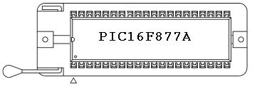

I inserted the PIC16F877A microcontroller to the ZIF socket of the programmer in the right direction

Neo wrote: Can you put a photo of the programmer with the IC to see whether you placed it in the right direction?[
My camera doesn't capture a clear image of it.
There a simple graphic of it.
Re: A trouble with JDM programmer
Post by Neo » Tue Apr 27, 2010 8:33 pm
If you placed the PIC as on image, then it is correct.

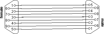

Now winpic800's hardware test says that
Opening COM1
Hardware Ok.
but in detect device it says that
Opening COM1
Detected -> UNKNOWN
Serial cable works as below. is it correct?
Post by Neo » Wed Apr 28, 2010 5:56 pm
I have removed some posts since those might disrupt other readers.
Cable is 100% correct. Also the the JDM programmer was tested before sending. Now I suspect your serial port.
