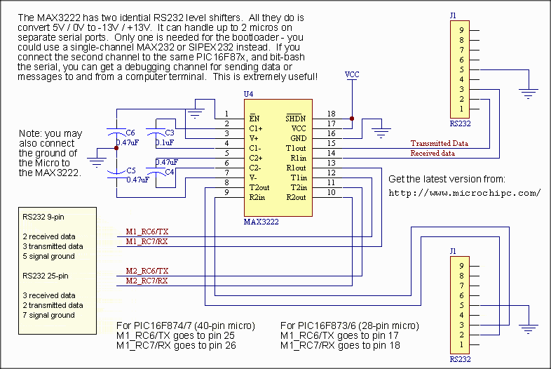

Most of the people complaining that they can not connect there microcontrollers to PC. The reason for this in many occasions , is wrong pin connections between MAX232 IC and PC and also MAX232 IC with microcontroller. Here you can
see very clear diagram , which explain all the story between PC- MAX232 - Microcontroller inter - connections.
Re: Connecting your Microcontroller to PC
Posted: Tue Jun 22, 2010 10:59 am
by SukhdeepMankoo
Note DB-9
pin 3 is the transmit pin of PC.
pin 2 is the receive pin of PC.
I have seen the schematic diagram, if u will interchange the pin2 and pin3 of DB-9 connector, it will work.

If you are a beginner, I would recommend you to use either PIC16F877A or 16F84. Both are easy to handle and more importantly there are lots of support on the web. In addition to the first diagram, you could use the following one as well. (Both same).
