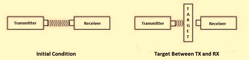

Thru-Beam Mode Ultrasonic Sensor
Ultrasonic Sensor Thru-Beam Mode
In this mode ultrasonic transmitter and receiver are two separate units as shown in the above diagram. Transmitter emits high frequency sound waves and receiver detects it. A target can easily detected when it block the signals send by the transmitter.

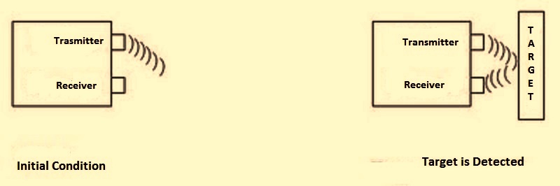

Diffuse Reflective Mode Ultrasonic Sensor
Ultrasonic Sensor Diffuse Reflective Mode
In this mode Ultrasonic transmitter and receiver are put together in a single package as shown in the above diagram. The ultrasonic transmitter continuously emits high frequency sound waves. When a target comes within the operating range of the sensor, the receiver will get the echo reflected from the target.

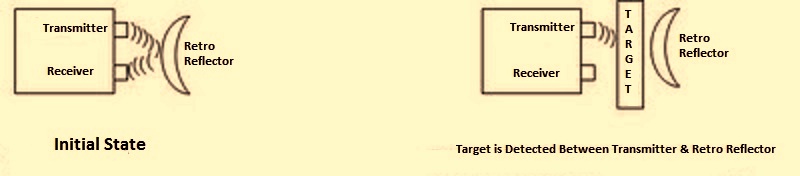

Retro-Reflective Mode Ultrasonic Sensor
Ultrasonic Sensor Retro-Reflective Mode
In this mode we are using one more component called Retro-Reflector. As in the previous case transmitter and receiver are in the same package. Usually this mode is used to detect target which is far from the sensors. The retro-reflector is placed a little far away from the Ultrasonic Sensors. The high frequency sound waves emitted by the transmitter is reflected by the retro-reflector and it is detected by the receiver. Thus when a target comes across the sensor and retro-reflector the ultrasonic waves will not reflected back to receiver. Here is one problem, the wave may get reflected from the target itself, to avoid this a polarizing filter is used in the sensor such that it detects only the wave reflected from the retro-reflector.

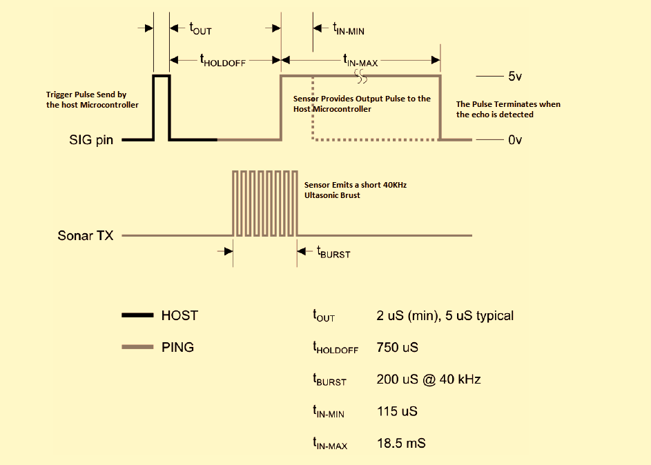

Ultrasonic Distance Sensor : PWM Output
The PING ))) Ultrasonic Sensor detects objects or measure distance by emitting a short ultrasonic burst and listening for its echo. Its operation is explained in the following steps.
1.The host microcontroller provides a trigger pulse.
2.The sensor emits a short 40 KHz ultrasonic burst.
3.The output of the Sensor becomes High.
4.The ultrasonic burst travels through air about a speed of 1300 feet per second.
5.The ultrasonic waves hits a target and gets reflected back.
6.The sensor detects the echo.
7.The output of the Sensor becomes Low.
Ultrasonic PING Sensor Operation
