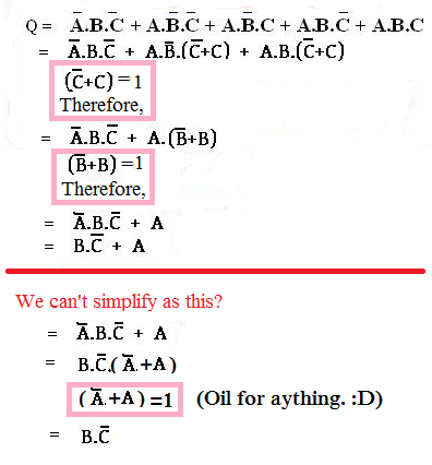

Nandika wrote::D I got it,Rksk thanx
As this,
Am I correct...Please tell?
no no, C+Cbar=1
Re: Create simple circuit using Logic gates
Post by Rksk » Sun Sep 09, 2012 11:48 am
As this,
no no, C+Cbar=1

According to Complementary Law,This can't do ?
he he.PNG (49.59 KiB) Viewed 11376 times
As this,
no no, C+Cbar=1
yes..yes..C + C bar =1 ... According to Complementary law...
First,I wrote C + C bar=0 ..But,after Edit it.

Nandika wrote:According to Complementary Law,This can't do ?
How did you write 2nd one's 2nd line? There isn't common things.
