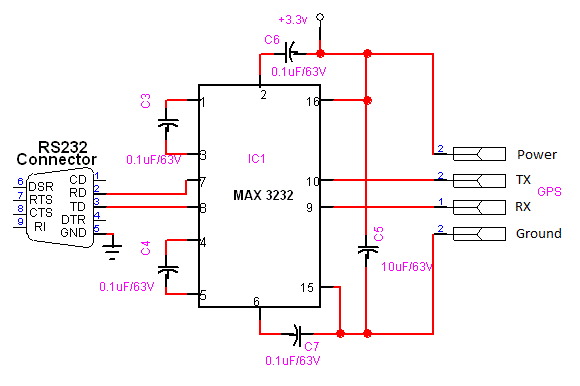

As an embedded design, the GPS module provides direct CMOS compatible TTL level serial I/O. The RX and TX signals on the I/O connector are driven directly by the UART on the GPS receiver. Interfacing these signals directly to a UART in your application circuitry provides direct serial communication without the complication of RS-232 or RS-422 line drivers.
If we want to connect the GPS receiver to any RS232 serial port you need a converter. MAX3232 is an serial driver IC which can operate from 3V to 5V.
If you are from Sri Lanka, you can buy from TRONIC.LK for cheap.
If you made the connections clearly, you will get the data (most probably in NMEA protocol) to your PC. You can easily view then with Hyper terminal.

To get this circuit working, you will need to make 3.3V. Have a look at article How to make 3.3V from 5V
