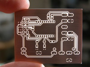

Follow these steps to etch the board:
1.Pour the etchant normally ferric chloride, into the plastic tray carefully, avoiding spills and splashes.
2.Dunk the board into the tray and continually rock it back and forth.
3.Keep the board in the solution for 10 to 30 minutes (depending on the type and strength of the etchant) or until the etchant has removed all the excess copper. Keep shaking the tray gently moving back and forth.
4.Use the plastic or wooden tongs to lift the board out of the tray from time to time to check progress.
The etchant removes the copper, starting from the edges and areas close to resist. If you’ve gone through these steps, you’ve almost created your finished board. The etchant has completed etching when you can’t see any traces of exposed copper. Now you can drill the board and place the components in it.
