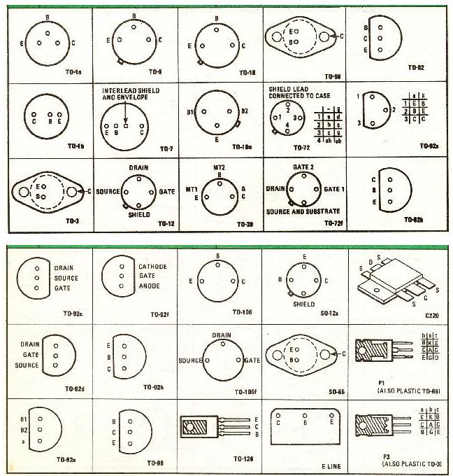

For most electronic people , identify the pin outs of a transistor is a big headache. But if you know the package type of the transistor , most of the time , you can easily identify the pin outs. Because most of the trasnsistor manufacturing companies , making there components in standard packages. Below you can see famous package types of trasistors and there pin configurations.
How to identify PIN Outs of a Transistor
