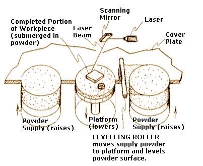

Selective Laser Sintering (SLS®, registered trademark by DTM™ of Austin, Texas, USA) is a process that was patented in 1989 by Carl Deckard, a University of Texas graduate student. Its chief advantages over Stereolithography (SLA) revolve around material properties. Many varying materials are possible and these materials can approximate the properties of thermoplastics such as polycarbonate, nylon, or glass-filled nylon.
As the figure below shows, an SLS® machine consists of two powder magazines on either side of the work area. The leveling roller moves powder over from one magazine, crossing over the work area to the other magazine. The laser then traces out the layer. The work platform moves down by the thickness of one layer and the roller then moves in the opposite direction. The process repeats until the part is complete.

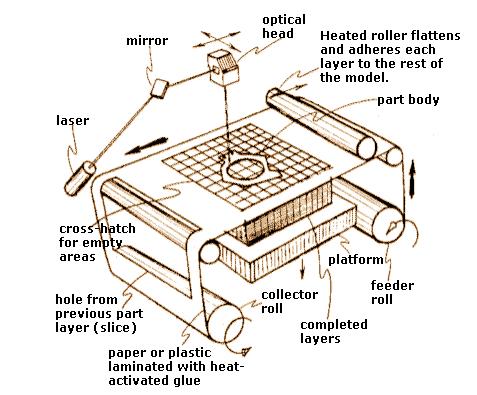

Laminated Object Manufacturing
Material is usually a paper sheet laminated with adhesive on one side, but plastic and metal laminates are appearing.
Layer fabrication starts with sheet being adhered to substrate with the heated roller.
The laser then traces out the outline of the layer.
Non-part areas are cross-hatched to facilitate removal of waste material.
Once the laser cutting is complete, the platform moves down and out of the way so that fresh sheet material can be rolled into position.
Once new material is in position, the platform moves back up to one layer below its previous position.
The process can now be repeated.
The excess material supports overhangs and other weak areas of the part during fabrication. The cross-hatching facilitates removal of the excess material. Once completed, the part has a wood-like texture composed of the paper layers. Moisture can be absorbed by the paper, which tends to expand and compromise the dimensional stability. Therefore, most models are sealed with a paint or lacquer to block moisture ingress.
The LOM™ developer continues to improve the process with sheets of stronger materials such as plastic and metal. Now available are sheets of powder metal (bound with adhesive) that can produce a "green" part. The part is then heat treated to sinter the material to its final state.

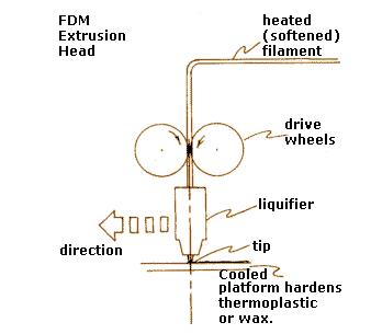

• Filament of heated thermoplastic polymer is squeezed out like toothpaste from a tube.
• Thermoplastic is cooled rapidly since the platform is maintained at a lower temperature.
• Milling step not included and layer deposition is sometimes non-uniform so "plane" can become skewed.
• Not as prevalent as SLA and SLS®, but gaining ground because of the desirable material properties.
Stratasys of Eden Prairie, MN makes Fused Deposition Modeling (FDM) machines. The FDM process was developed by Scott Crump in 1988. The fundamental process involves heating a filament of thermoplastic polymer and squeezing it out like toothpaste from a tube to form the RP layers. The machines range from fast concept modelers to slower, high-precision machines. The materials include polyester, ABS, elastomers, and investment casting wax

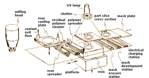

Solid Ground Curing, also known as the Solider Process, is a process that was invented and developed by Cubital Inc. of Israel. The overall process is illustrated in the figure above and the steps are illustrated below. The SGC process uses photosensitive resin hardened in layers as with the Stereolithography (SLA) process. However, in contrast to SLA, the SGC process is considered a high-throughput production process. The high throughput is achieved by hardening each layer of photosensitive resin at once. Many parts can be created at once because of the large work space and the fact that a milling step maintains vertical accuracy. The multi-part capability also allows quite large single parts (e.g. 500 × 500 × 350 mm / 20 × 20 × 14 in) to be fabricated. Wax replaces liquid resin in non-part areas with each layer so that model support is ensured

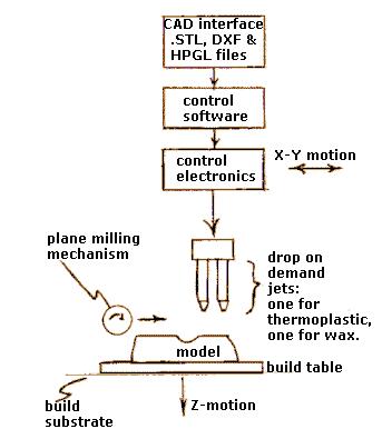

The Sander ModelMaker™ product is produced and distributed by Sanders Prototype, Inc. of Wilton, NH, USA. Smooth cosmetic surface quality can be achieved by pre-tracing the perimeter of a layer prior to filling in the interior. The supporting wax material is deposited at the same time as the thermoplastic.
Both the thermoplastic material (Protobuild™) and the wax support material (Protosupport™) are proprietary materials of Sanders

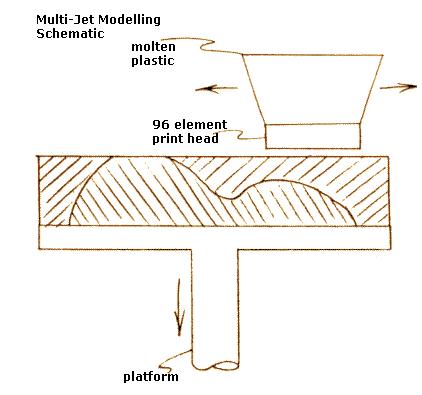

Another product of 3D Systems from the makers of the SLA system, Multi-Jet Modeling™ uses a 96-element print head to deposit molten plastic for layering. The system is fast compared to most other RP techniques, and produces good appearance models with minimal operator effort. The main market that this system is targeted at is the engineering office where the system must be non-toxic, quiet, small, and with minimal odor

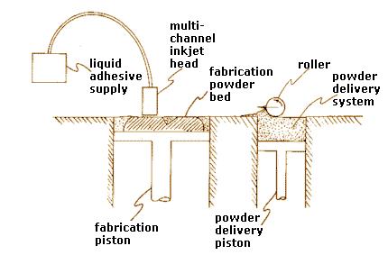

• Binder is "printed" on unbound powder layer.
• Without milling step, work plane can become successively skewed.
• Not as established as SLA and SLS®.
Three-Dimensional Printing, developed by MIT and Soligen, Inc., is illustrated below. It is another technique based on the inkjet printing process. Binder is printed on a powder layer to selectively bind powder together for each layer.
