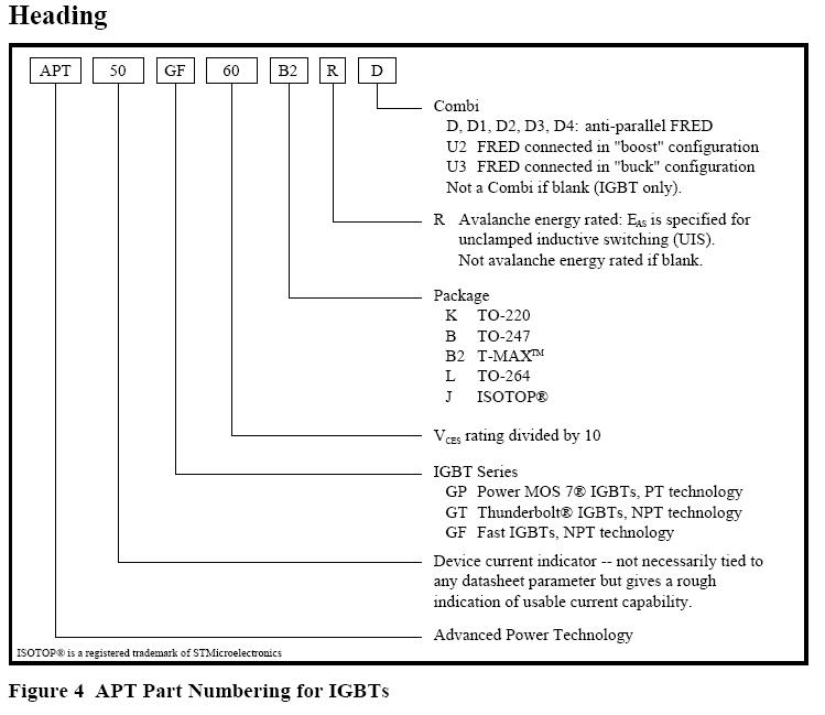

How to Select an IGBT
This section is intentionally placed before the technical
discourse. Answers to the following set of burning
questions will help determine which IGBT is
appropriate for a particular application. The
differences between Non Punch-Through (NPT) and
Punch-Through (PT) devices as well as terms and
graphs will be explained later.
1. What is the operating voltage? The highest
voltage the IGBT has to block should be no more
than 80% of the VCES rating.
2. Is it hard or soft switched? A PT device is better
suited for soft switching due to reduced tail
current, however a NPT device will also work.
3. What is the current that will flow through the
device? The first two numbers in the part number
give a rough indication of the usable current. For
hard switching applications, the usable frequency
versus current graph is helpful in determining
whether a device will fit the application.
Differences between datasheet test conditions and
the application should be taken into account, and
an example of how to do this will be given later.
For soft switching applications, the IC2 rating could
be used as a starting point.
4. What is the desired switching speed? If the
answer is “the higher, the better”, then a PT device
is the best choice. Again, the usable frequency
versus current graph can help answer this question
for hard switching applications.
5. Is short circuit withstand capability required? For
applications such as motor drives, the answer is
yes, and the switching frequency also tends to be
relatively low. An NPT device would be required.
Switch mode power supplies often don’t require
short circuit capability.

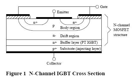

IGBT Overview
An N-channel IGBT is basically an N-channel power
MOSFET constructed on a p-type substrate, as
illustrated by the generic IGBT cross section in Figure
1. (PT IGBTs have an additional n+ layer as well as
will be explained.) Consequently, operation of an
IGBT is very similar to a power MOSFET. A positive
voltage applied from the emitter to gate terminals
causes electrons to be drawn toward the gate terminal
in the body region. If the gate-emitter voltage is at or
above what is called the threshold voltage, enough
electrons are drawn toward the gate to form a
conductive channel across the body region, allowing
current to flow from the collector to the emitter. (To
be precise, it allows electrons to flow from the emitter
to the collector.) This flow of electrons draws positive
ions, or holes, from the p-type substrate into the drift

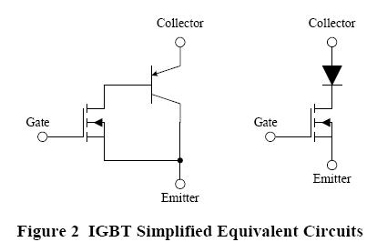

region toward the emitter. This leads to a couple of
simplified equivalent circuits for an IGBT as shown in
Figure 2.
The first circuit shows an N-channel power MOSFET
driving a wide base PNP bipolar transistor in a
Darlington configuration. The second circuit simply
shows a diode in series with the drain of an N-channel
power MOSFET. At first glance, it would seem that
the on state voltage across the IGBT would be one
diode drop higher than for the N-channel power
MOSFET by itself. It is true in fact that the on state
voltage across an IGBT is always at least one diode
drop. However, compared to a power MOSFET of the
same die size and operating at the same temperature
and current, an IGBT can have significantly lower on
state voltage. The reason for this is that a MOSFET is
a majority carrier device only. In other words, in an Nchannel
MOSFET only electrons flow. As mentioned
before, the p-type substrate in an N-channel IGBT
injects holes into the drift region. Therefore, current
flow in an IGBT is composed of both electrons and
holes. This injection of holes (minority carriers)
significantly reduces the effective resistance to current
flow in the drift region. Stated otherwise, hole
injection significantly increases the conductivity, or the
conductivity is modulated. The resulting reduction in
on state voltage is the main advantage of IGBTs over
power MOSFETs.
Nothing comes for free of course, and the price for
lower on state voltage is slower switching speed,
especially at turn-off. The reason for this is that during
turn-off the electron flow can be stopped rather
abruptly, just as in a power MOSFET, by reducing the
gate-emitter voltage below the threshold voltage.
However, holes are left in the drift region, and there is
no way to remove them except by voltage gradient and
recombination. The IGBT exhibits a tail current during
turn-off until all the holes are swept out or recombined.
The rate of recombination can be controlled, which is
the purpose of the n+ buffer layer shown in Figure 1.
This buffer layer quickly absorbs trapped holes during
turn-off. Not all IGBTs incorporate an n+ buffer layer;
those that do are called punch-through (PT), those that
do not are called non punch-through (NPT). PT IGBTs
are sometimes referred to as asymmetrical, and NPT as
symmetrical.

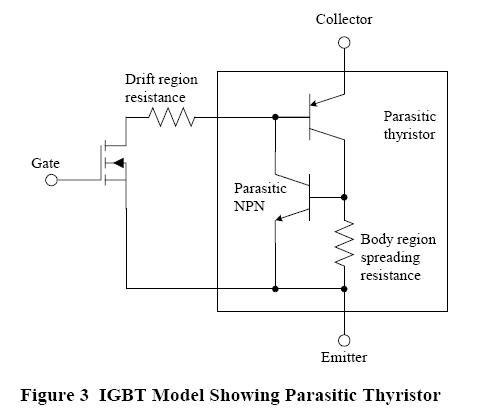

The other price for lower on state voltage is the
possibility of latchup if the IGBT is operated well
outside the datasheet ratings. Latchup is a failure mode
where the IGBT can no longer be turned off by the
gate. Latchup can be induced in any IGBT through
misuse. Thus the latchup failure mechanism in IGBTs
warrants some explanation.
The basic structure of an IGBT resembles a thyristor,
namely a series of PNPN junctions. This can be
explained by analyzing a more detailed equivalent
circuit model for an IGBT shown in Figure 3.
A parasitic NPN bipolar transistor exists within all Nchannel
power MOSFETS and consequently all N channel IGBTs. The base of this transistor is the body
region, which is shorted to the emitter to prevent it
from turning on. Note however that the body region
has some resistance, called body region spreading
resistance, as shown in Figure 3. The P-type substrate
and drift and body regions form the PNP portion of the
IGBT. The PNPN structure forms a parasitic thyristor.
If the parasitic NPN transistor ever turns on and the
sum of the gains of the NPN and PNP transistors are
greater than one, latchup occurs. Latchup is avoided
through design of the IGBT by optimizing the doping
levels and geometries of the various regions shown in
Figure 1.
The gains of the PNP and NPN transistors are set so
that their sum is less than one. As temperature
increases, the PNP and NPN gains increase, as well as
the body region spreading resistance. Very high
collector current can cause sufficient voltage drop
across the body region to turn on the parasitic NPN
transistor, and excessive localized heating of the die
increases the parasitic transistor gains so their sum
exceeds one. If this happens, the parasitic thyristor
latches on, and the IGBT cannot be turned off by the
gate and may be destroyed due to over-current heating.
This is static latchup. High dv/dt during turn-off
combined with excessive collector current can also
effectively increase gains and turn on the parasitic
NPN transistor. This is dynamic latchup, which is
actually what limits the safe operating area since it can
happen at a much lower collector current than static
latchup, and it depends on the turn-off dv/dt. By
staying within the maximum current and safe operating
area ratings, static and dynamic latchup are avoided
regardless of turn-off dv/dt. Note that turn-on and
turn-off dv/dt, overshoot, and ringing can be set by an
external gate resistor (as well as by stray inductance in
the circuit layout).
