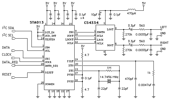

It is a common question asked over the net on how to make a good quality MP3 player. By using STA013 and CS4334 chips in combination can make this dream come true. Here is the schematics.
All you have to do is, find a microcontroller with I2C bus and write MP3 data directly over that. Rest will be handled by the chip. Enjoy!

With those all in one chips, you will hardly find an I2C (or SPI) interface to connect a microcontroller which can then feed raw PCM them. So those are not much attracted to electronic enthusiasts.

I don't think this is very easy as this hobby project.
not discouraging you. But the simple hobby circuit lacks following.
1. A good bypass mechanism to keep away HF signals from supply bus lines.
2. design the power supply unit.
3. temperature independent voltage reference circuit.
5. Terminal voice cancelling circuit.
