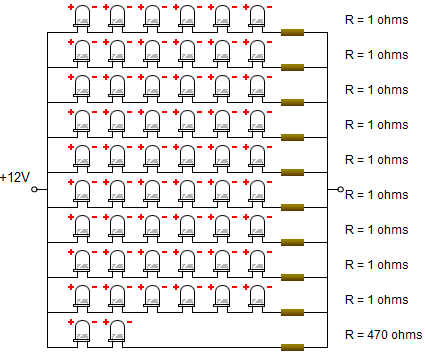

What is the best way to soldering this 56Leds ?
i have power pack 12V/1.8W . will it be ok for this matter?
  • each 1 ohm resistor dissipates 0.4 mW (1/4W is enough)
  • the 470 ohm resistor dissipates 188 mW (use 1/2W)
  • together, all resistors dissipate 191.6 mW
  • together, the LEDs dissipate 2240 mW
  • total power dissipated by the array is 2431.6 mW
  • the array draws current of 200 mA from the source
  • you must use a 2.4W power supply (1.8W is not enough)

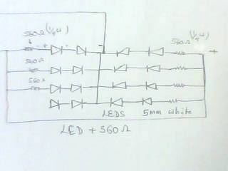

Thanks. But i can't buy transformer for this. Don't you have any good idea for drive 56nos white led?
What do you think my idea picture (Led+560)
This is low budjet project. Pls. Help me.

I have 9v 400MA transformer, when i conect it DC cc't it will 11.8v 400ma. will it be ok? Whta about led soldering methad ? My idea (picture led+560) it will be ok?

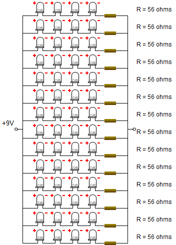

You can rearrange the LEDs and change the value of resistors to compensate with that power supply.
However, if you put 2 LEDs per line (there will be 56/2 = 28 lines) as in your picture, it will take 28 x 20mA = 560mA which your power supply can't tolerate. You can make it in the following way.
  • each 56 ohm resistor dissipates 22.4 mW (1/4W)
  • together, all resistors dissipate 313.6 mW
  • together, the diodes dissipate 2240 mW
  • total power dissipated by the array is 2553.6 mW
  • the array draws current of 280 mA from the source
