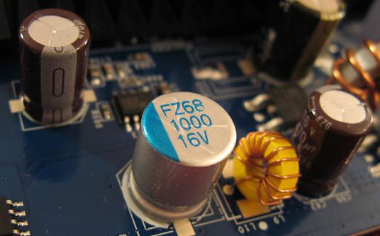

There are many types of capacitors in the market. Polymer capacitors and Wet electrolytic capacitors sometime looks same except the Polymer ones doesn't have cut shapes (called vents) on top. If you can see there is some type of a cut it is just a sleeveless wet electrolytic capacitor. It is important though not to confuse low capacitance value wet electrolytic caps (below 330uf) with polymers because they also do not have vents.
In this image, note that the two purple ones are polymer caps where as the black on is a wet electrolytic cap.
Guess what's the type of the blue one? (Notice the K mark on top. It is just a wet electrolytic cap).

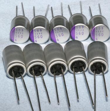

Radial Polymer Capacitors

Polymer capacitor
Polymer capacitors, polymerized organic semiconductor solid-electrolyte capacitors and conductive polymer capacitors with different chemistry, are types of electrolytic capacitor with solid, rather than the more usual liquid, electrolyte. Names used for similar technologies are OS-CON (Sanyo trademark), Aluminum Organic Polymer Capacitors (AO-CAPS), Organic Conductive Polymer Aluminum Electrolytic Capacitor (OC-CON).
Characteristics
  • Some types have longer life at higher cost than standard (liquid) electrolytics. 50Khours life at 85 °C. Others are specified typically for guaranteed 1000 hours at 105 °C.
  • Equivalent series resistance (ESR) is lower than electrolytic of same value, and stable under varying temperature, unlike standard electrolytics.
  • Working voltage up to around 35 V.
Construction
  • Cathode is aluminum foil.
  • A separator sheet is impregnated with electrolyte.
  • Anode is aluminum foil with an oxide layer.
Sandwich is rolled and assembled into a leaded or surface-mount can.
