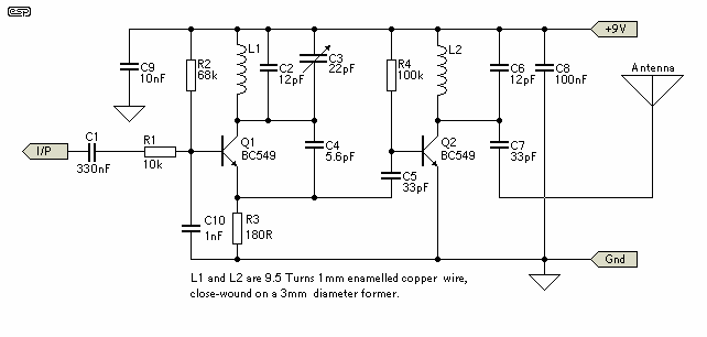

you can find a small fm microphone & a fm reciever circuit from an electronic shop easily. also if you are interested in building ciruits you can try one like below one. but building a fm reciever is not a good idea.
http://sound.westhost.com/project54.htm

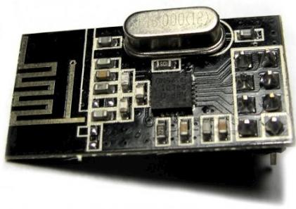

I found it is hard to make RF transceivers even with years of expereince. Even it is a kind of worthless when the working guaranteed modules are already available.
NRF24L01 Wireless Transceiver Module is one good example. You can buy two of them for < $8 and I'm sure it will cost you more to even build one. Have a look at this eBay deal. http://cgi.ebay.com/Arduino-NRF24L01-Wi ... 415b5fd1b8.
The coding would be very easy.

You can find a sample TX, RX code here:
nRF24L01_Demo_For_Arduino.zip
(7.61 KiB) Downloaded 1487 times
If you really want to build it yourself, you can find the schematic in the following archive.
NRF24L01_module.zip
(1.18 MiB) Downloaded 963 times
More information can be found in Arduino site.
