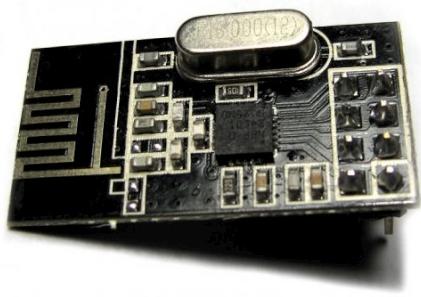

I found it is hard to make RF transceivers even with years of expereince. Even it is a kind of worthless when the working guaranteed modules are already available.
NRF24L01 Wireless Transceiver Module is one good example. You can buy two of them for < $8 and I'm sure it will cost you more to even build one. Have a look at this eBay deal. http://cgi.ebay.com/Arduino-NRF24L01-Wi ... 415b5fd1b8.
The coding would be very easy.

If you really want to build it yourself, you can find the schematic in the following archive.
NRF24L01_module.zip
(1.18 MiB) Downloaded 965 times
More information can be found in Arduino site.
