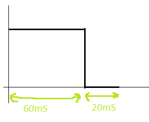

namuth me wave ekedi yam karyayak(Duty) karanne uparima agaya witharai...api duty cucle kiyanne mulu awartha kalayen menna me karyayak(Duty) karana kalaya prathishathayak widiyata aragena...
hithanna, square wave ekaka awartha kalaya 60mS kiyala eken uparima wela thiyena kalaya(Duty ekak karana kalaya) 20mS...mahatha rupe widiyata apita eka penwanna puluwan...
min max.png (2.92 KiB) Viewed 17538 times
dan api meke Duty Cycle 1 balamu....
Duty Cycle= uparima vi pawathina kalaya/mulu awartha kalaya*100%
me wave ekedi,
Duty cycle=60mS/80mS*100%=75%
me duty cycle ekata wave eke sankayathay balapamak na...Amplitude eka balapanneth na...
