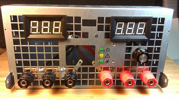

Also, you might be able to beautify your power supply as below :)
