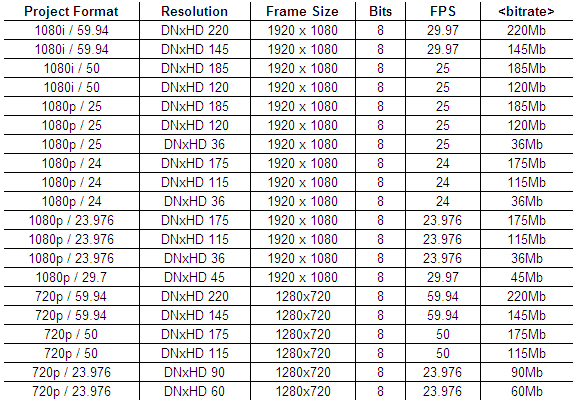

VC-3 (aka Avid DNxHD) Encoding
ffmpeg -i <input_file> -vcodec dnxhd -b <bitrate> -an output.mov
Notes :
- <bitrate> can take the following values : 36Mb, 60Mb, 90Mb, 120Mb, 185Mb ( please refer to the following table ).
- Add the following option for interlaced modes : -flags +ildct
- Add the following option for best quality mode ( very slow ! ) : -mbd rd
Supported Resolutions :
Supported resolutions.jpg (337.67 KiB) Viewed 32305 times
