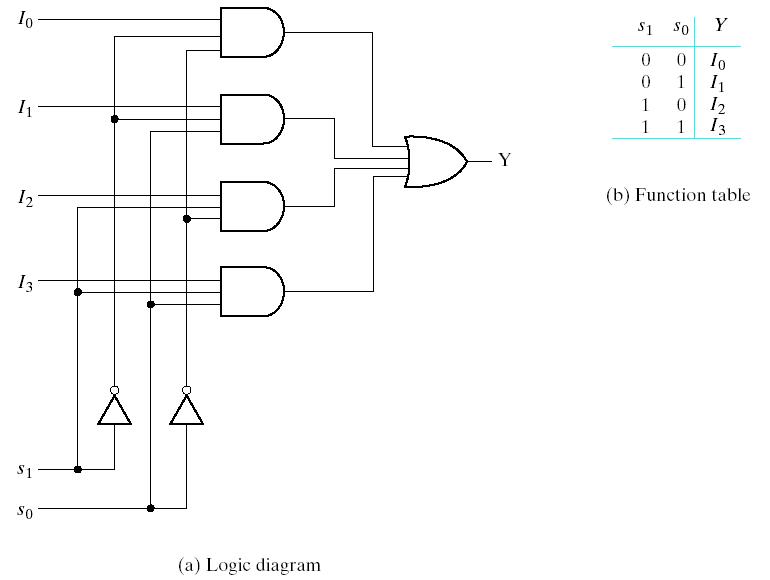

//Behavioral description of 4-to-1- line multiplexer
module mux4x1_bh (i0,i1,i2,i3,select,y);

Behavioral modelling of 4-1 Line Multiplexer in Verilog
