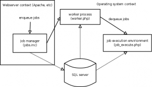

My solution ended up being a mix of the two above. It consists of three major parts and, a bit simplified, works like this
  1. Job information is stored in a SQL database.
  2. An external CLI-based worker PHP-script is launched from inside the web page script using proc_open.
  3. The worker script, which is running in an isolated PHP process calls pcntl_fork to create a duplicate of itself. The parent returns directly to the web page script.
  4. The child process of the worker script now runs free of any webserver process and can now retrieve job information from the SQL database. When all jobs are executed it kills itself.
Here is a nice block diagram that shows the interaction of the components
And viola, we have asynchronous background execution of (almost) arbitrary PHP functions. There are a few problems left to solve, we’ll tackle those further down.
