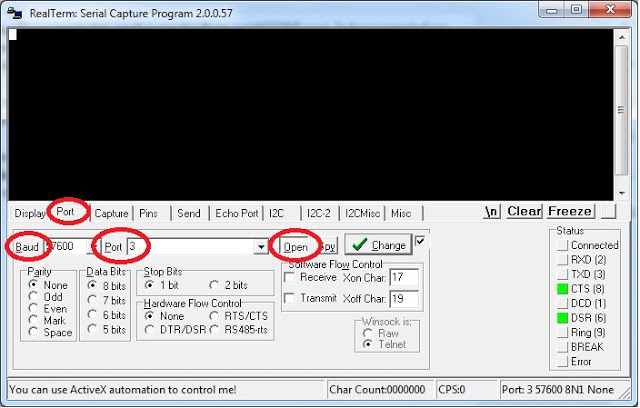

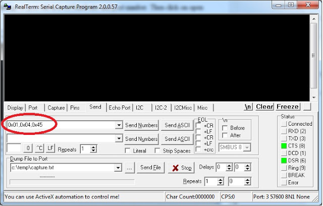

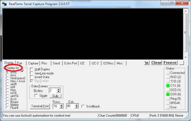

Here is nice and easy to use but also feature rich application which can send hex data easily from serial port to an external device.
Download from here: http://sourceforge.net/projects/realterm/
Here's how you could do it.
Sending hex data from serial port (USB) to a device
