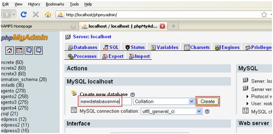

4. Make a database for Magento demo store at your WampServers phpmyadmin interface as shown below. Write down the database name, user name, and password as you will need these later.
a) Create New Database.
Phpmyadmin -> Create new database – Database name –> Create.

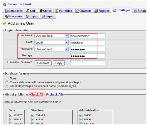

b) Add New User and User Password.
Server: localhost -> Privileges-> Add a new User -> Select appropriate drop downs as shown below; put your username & password -> Check all privileges -> GO.

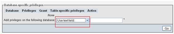

c) Add User to Database.
Server: localhost -> Privileges -> Select username -> Edit privileges
Database specific privileges -> Select Database name from drop down
The page will refresh-> Check all privileges -> Go.
