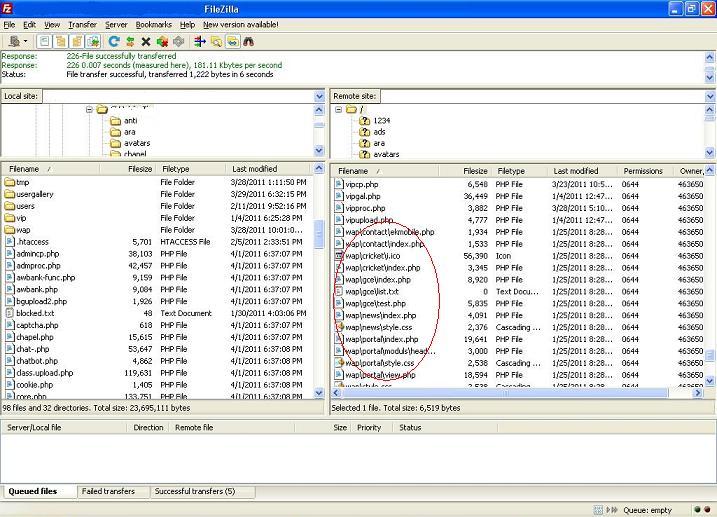

I uploaded a ZiP file with some files to my FTP account & used below php to extract them.
    $filename = $_GET['archive'];
 if ($filename){
    $zip = new ZipArchive;
    if ($zip->open($filename) === TRUE) {
        $zip->extractTo('./');
        $zip->close();
        echo 'The file <strong>'.$filename.'</strong> Extracted successfully';
        unlink($filename);
    }    else {
        echo 'failed';
But after it some files have filenames like wap\contact\index.php. I can't rename or delete these files using filezilla, because it gets an error 550 Prohibited file name: wap\contact\index.php

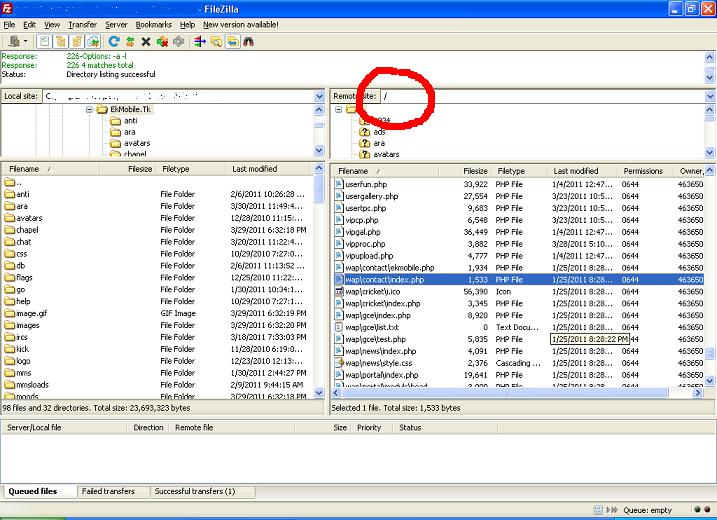

There is a Screen capture of FileZilla, Please anyone help me to remove these files.
Thank you.

Post by Rksk » Sun Apr 03, 2011 10:31 am
Mysoogal wrote:644, you need to chmod your files, into 755 ot 777
It is unable to do.
Status: Set permissions of '/wap\contact\index.php' to '777'
Command: SITE CHMOD 777 wap\contact\index.php
Response: 550 Prohibited file name: wap\contact\index.php

Post by Rksk » Mon Apr 04, 2011 1:58 pm
Neo wrote:I logged in using FTP and was able to delete the file /wap/contact/index.php without any problem.
No, the file is still there. I think you haven't understood my problem.
/wap/contact/index.php is a file name. It is in my Root. Goto my Root & scroll down, you will can see the problem.
Thank you.
