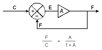

In order to discuss the effects of PID, it is necessary to look at a basic closed loop servo and the equation for its closed loop response. This was discussed in detail on page 39 of the September/October 1990 issue of Motion Control. The block diagram and the response formula are repeated here for your convenience:

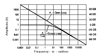

It is also important that one visualizes this equation by viewing the Bode diagram. Bode diagrams were discussed on page 45 of the January 1991 issue of Motion Control. A Bode diagram is simply a plot of the open loop (A) and closed loop A/(1 +A) responses of the servo in relation to frequency. A Bode diagram is shown below, again for your convenience.
Remember that A/(1 +A) is approximately equal to 1 when A is large and to A when A is small - as shown on the diagram above.

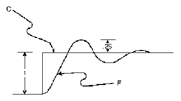

As A' approaches 1 on the Bode diagram (at 10 rad/sec. in the example), the denominator becomes 1 + 1 < -180° = 1-1 = 0 and F/C becomes infinite! This will result in severe oscillations. In order to maintain a stable system, the denominator must not be allowed to approach 0. When the term "phase margin" is used, it expresses how close the phase shift of A' is to -180° when A' = 1 in magnitude. A commonly accepted design goal is for A' to have -135° of phase shift or less (45° of phase margin). This will result in a 25 percent overshoot of the closed loop system in response to small step inputs in position as shown below.
As the phase margin gets larger, the amount and number of overshoots diminish. As the phase margin gets smaller, the overshoots get larger and will "ring" for longer periods until finally constant "ringing" or sustained oscillation will occur.

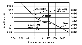

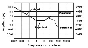

A Bode diagram of the whole PID compensation network would be:
Combining this with the Bode diagram shown earlier for the "naked" loop illustrates that this PID compensation has resulted in a closed loop servo with a wider bandwidth and a greater gain (thus accuracy) within that bandwidth.
