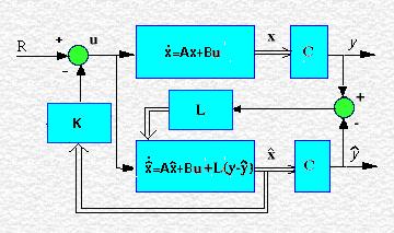

When we can't measure all the states x (as is commonly the case), we can build an observer to estimate them, while measuring only the output y = C x. For the magnetic ball example, we will add three new, estimated states to the system. The schematic is as follows
The observer is basically a copy of the plant; it has the same input and almost the same differential equation. An extra term compares the actual measured output y to the estimated output y_bar ; this will cause the estimated states x_bar to approach the values of the actual states x. The error dynamics of the observer are given by the poles of (A-L*C).

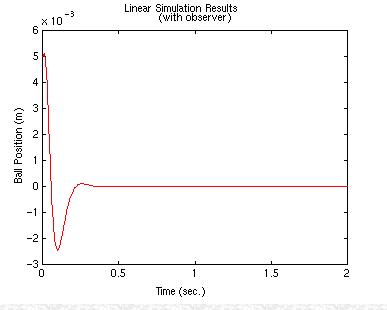

To see how the response looks to a nonzero initial condition with no reference input, add the following lines into your m-file. We typically assume that the observer begins with zero initial condition,x_bar =0. This gives us that the initial condition for the error is equal to the initial condition of the state.
lsim(At,Bt,Ct,0,zeros(size(t)),t,[x0 x0])
Ct = [ C zeros(size(C))];

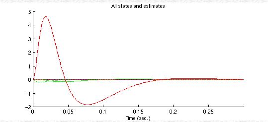

Responses of all the states are plotted below. Recall that lsim gives us x and e; to get x_bar. we need to compute x-e.

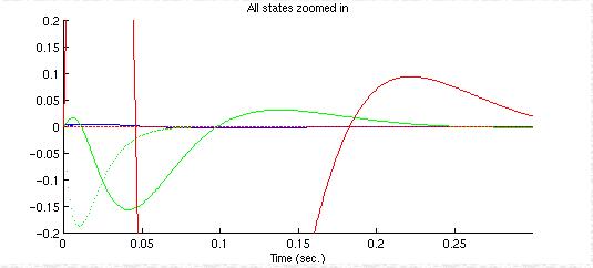

Zoom in to see some detail
The blue solid line is the response of the ball position , the blue dotted line is the estimated state .
The green solid line is the response of the ball speed , the green dotted line is the estimated state.
The red solid line is the response of the current, the red dotted line is the estimated state .
We can see that the observer estimates the states quickly and tracks the states reasonably well in the steady-state.
