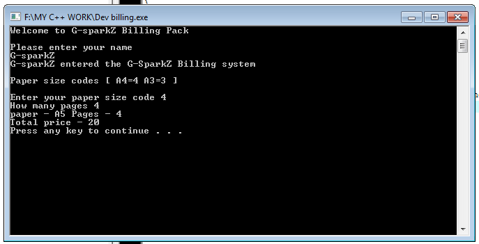

Post by Face » Thu Nov 11, 2010 7:24 pm
I wrote little code.I will use this new topic to make some changes in it.Because our C++ topic is becoming bigger & bigger.
Here is my little code
//G-sparkz little billing Pack Devoloped
#include<iostream>
using namespace std;
int main()
    int Paper,Quantity,Total;
    char Name[50];
    cout<<"Welcome to G-sparkZ Billing Pack"<<endl<<endl;
    cout<<"Please enter your name"<<endl;
    cin>>Name;
    cout<<Name <<" entered the G-SparkZ Billing system "<<endl<<endl;
    cout<<"Paper size codes [ A4=4 A3=3 ] "<<endl<<endl;
    cout<<"Enter your paper size code ";
    cin>>Paper;
    if(Paper==4)
    Paper=5;
    else if (Paper==3)
    Paper=10;
    else
    cout<<"wronge paper";
    cout<<"How many pages ";
    cin>>Quantity;
    cout<<"paper - A"<<Paper<< " Pages - "<< Quantity<<endl;
    Total=Paper*Quantity;
    cout<<"Total price - "<<Total<<endl;
    system("pause");
I wanna do some changes here.
1.I wanna stop my program if user input wrong paper code.
2.I wanna make some empty lines after "how many pages line"& after entering my name G-sparkZ.
billing 1.png (13.78 KiB) Viewed 10683 times

Re: little Billing pack
Post by Neo » Thu Nov 11, 2010 10:16 pm
void main()
    char Name[50];
    cin>>Name;
    cout << "\n\n\n\n" <<Name <<" entered the G-SparkZ Billing system "<<endl<<endl;
    cin>>Paper;
    if(Paper==4){
		Paper=5;
    else if (Paper==3){
		Paper=10;
    else{
		cout<<"wronge paper" << endl;
		return;
    cout<<"How many pages " << "\n\n\n";
    cin>>Quantity;
    system("pause");
Notice I have added multiple "\n" to make multiple end lines. "\n" is equals to endl.
You can also put multiple endls as well. Ex: << endl << endl << endl.......
The other one is "return;". See I used it after "wrong paper" to exit the application form there without proceeding further.
Note that I changed "int main()" to "void main()" again. Do not use anything without a meaning.
However, if you use int main(), make sure to use return x; where x is a number.
Good luck!

Post by Face » Thu Nov 11, 2010 11:03 pm
Thanks NEO.But I wanna stop my program when user input a wrong code * display wrong code.When I use return it exits when press enter.
Post by Neo » Fri Nov 12, 2010 12:09 am
Yes...
Find code,
      return;
Replace with,
      system ("pause");
      return;
