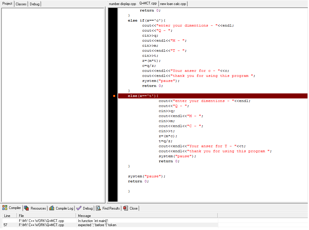

else(x=='t');{
Change it to (remove the invalid semicolon that made the compiler to terminate the else from there and execute next part with parentheses always),
else if(x=='t'){
Re: help on code
Posted: Mon Nov 15, 2010 8:20 pm
by Face
Thanks for helping me.I got a error while compiling without that (;)
Re: help on code
Posted: Mon Nov 15, 2010 9:13 pm
by Neo
It is still 'else' in your code. Should be changed to 'else if'. Otherwise you can't give a condition.
Re: help on code
Posted: Mon Nov 15, 2010 9:17 pm
by Face
Ohh...I didn't see that.Thanks.But still don't perform in correct way.always give 0 as answer.
