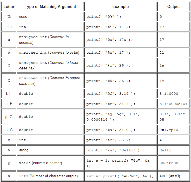

I already found some about printf() command.according to this table.
Conversion letters.
Conversion letters.
Cant I use this Conversion letters with variables?
