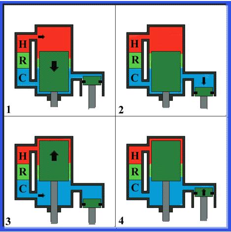

Working principle of the Displacer type Stirling engine
A displacer type Stirling engine makes working gas go and return between high temperature space and low temperature space by a displacer piston, and output the pressure variation that occurs by this gas movement as power by a power piston.
1 : Constant volume heating process
By the displacer piston moving to the side of compression space, the working gas in the engine becomes a higher temperature and flows to the expansion space, as passing through the heater. The gas pressure in the engine increases.
2 : Isothermal expansion process
By the pressure increased in engine, the power piston is pushed. The engine works to the outside.
3 : Constant volume cooling process
By the displacer piston moving to the side of expansion space, the working gas in the engine becomes a lower temperature and flows to compression space, as passing through a cooler. The gas pressure in the engine drops.
4 : Isothermal compression process
The power piston is pushed, and the engine is worked from the outside and discharges heat to the outside.
With an actual engine, both pistons don't move intermittently but sinusoidaly. By attaching a phase angle of 90 degree between a movement of both pistons, engines get a cycle that has such like these processes.

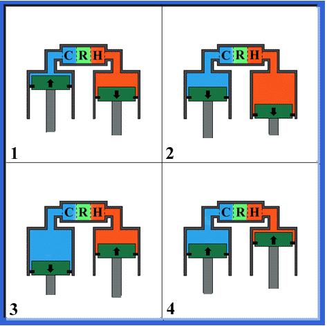

Fig : Working principle of the 2-piston type Stirling engine
With 2 piston type Stirling engine, a movement of the working gas and output of power is done by two power pistons. A phase difference of 90 deg. is attached to both power piston displacement.
With this process, the power piston on the side of a compression is upper, of expansion moves under. Working gas in the engine becomes a high temperature and flows to expansion space, as passing through a heater. A gas pressure in the engine increases.
In this process, both power pistons move to the lower side, and the working gas expands. The engine works to the outside.
In this process, the power piston on the side of a compression is lower, and of expansion moves upward. Working gas in the engine becomes a low temperature and flows to the compression space, as passing through a cooler. The gas pressure in the engine drops.
In this process, both power pistons move upward, and the working gas is compressed. The engine is worked from the outside and discharges heat to the outside.
With an actual engine, both pistons can not move intermittently. By attaching a phase angle of 90 deg. between both pistons that move sinusoidaly, engines have above-mentioned processes approximately.
