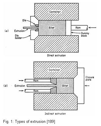

There are two basic types of extrusion:
Direct extrusion (or forward extrusion). The metal billet is driven through the die by the ram. The direction of the ram movement is the same as the extruded metal at the exit.
Indirect extrusion (also called inverted, or back extrusion). As the basic form, a hollow ram carries the die and pushes toward, to cause the metal flow out from the die in the direction against the direction of the ram and die. However, as a common form, of indirect extrusion, the ram containing the die is kept stationary, and the container with the billet is caused to move. This eliminates the relative motion between the wall of the container, and thus leads to lower friction forces and power requirement than that for direct extrusion. However, there are practical limitations to indirect extrusion, that is, the force the hollow ram can deliver is limited.

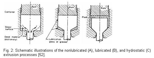

There are basically three variations of extrusion, depending on the lubrication technique used. In the nonlubricated extrusion process (Fig. 2, left), a flat face die is used, and the material flows by internal shear and causes a "dead-metal zone" to form in front of the extrusion die. In lubricated extrusion (Fig. 2, middle), dies with conical entrance angles are used. A suitable lubricant is present between the extruded billet and the extrusion tooling, i.e, the container and the die
The more recently developed technique for extrusion is hydrostatic extrusion. With this process, the billet may have a large length-to-diameter ratio (even coils of wire can be extruded) or it may have an irregular cross section. Since there is no container-billet friction, the curve of the extrusion pressure vs. ram travel is nearly flat. Because of the pressurized fluid, lubrication is very effective, and the extruded product has good surface finish and dimensional accuracy. Also it is possible to use dies with a very low semicone angle, which greatly minimizes the redundant deformation. Some limitations occur, however, for the hydrostatic extrusion. Besides the practical limit on fluid pressure, there are also problems in the control on the exit from the die due to large amount of stored energy in a pressurized fluid. Most recent development for the hydrostatic extrusion uses thick-film hydrostatic extrusion to minimize the amount of pressurized fluid (Fig. 2, right).
